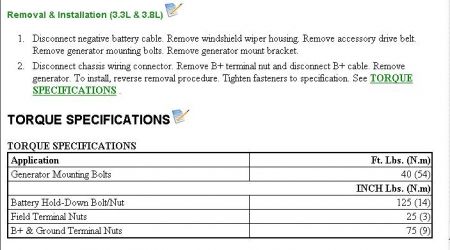

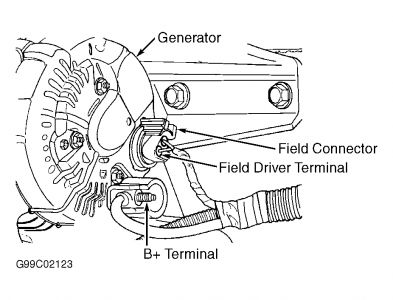

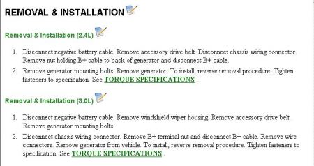

1999 Dodge Caravan alternater replacement
12,000 MILES • 6 CYL • FWD • AUTOMATIC
RODWMS
How to remove old and install new alternater
