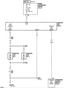

HEYYY!GUYSS, IM STILL HAVIN THE SAME PROBLEM WHITH ENGINE FANS, I PUT A BRAN NEW RELAY, BUT DONT START! ALSO I TEST BOTH FANS TO SEE IF THEY CRANK, AND ITS OK! SO I DONT KNOW WHAT IT THE REAL PROBLEM, ALSO I CHANGE THE WATER PUMP, HELP MEEEEE! IF THERES ANY OTHER RELAY INSIDE THE CAR

You never asked how to fix the fan nor did you ever post what the symptoms are. You just asked where components were as you knew what you were doing.
Here is the schematic
https://www.2carpros.com/forum/automotive_pictures/561653_Cooling_fan_wiring_99_Caravan_1.jpg
