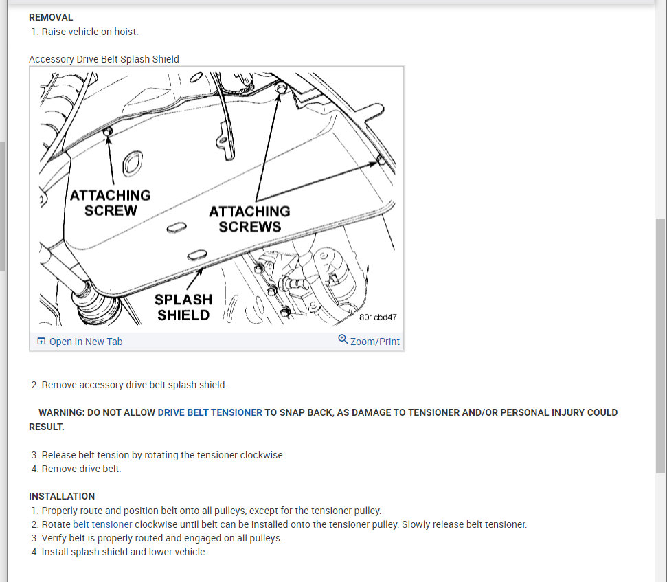

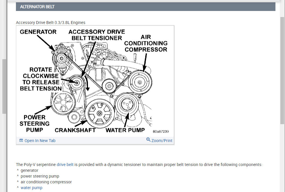

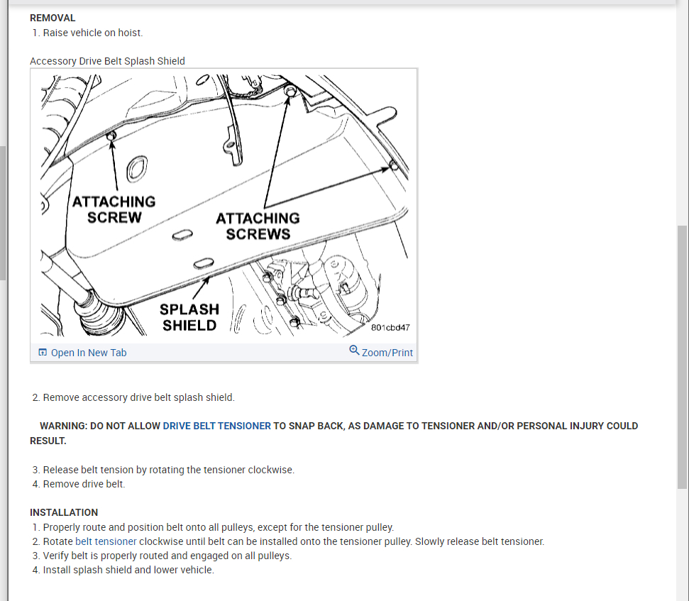

Here are a couple guides that will help with replacing the belt which is what will need to happen in case others will need that info:
Plus I included process below for replacing the belt with the routing. This will show possible locations you put the laser like above the compressor pulley aimed down towards the crank pulley.
