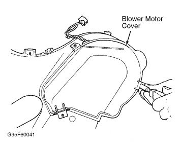

Heater problem
1999 Dodge Caravan 6 cyl Front Wheel Drive Automatic
where is the heater blow morot at in the van. I have looked and I dont see it. And how do I replace it when I find it and get a new one

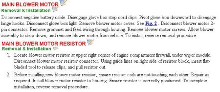

Before you replace that motor, answer me this. Does it run on high speed only, and no low speed? If it is, it is not the blower motor. It is the resistor.
Blower is behind the glove compartment. That needs to be taken out before you can even see it.
https://www.2carpros.com/forum/automotive_pictures/55316_99caravanblower_1.jpg
https://www.2carpros.com/forum/automotive_pictures/55316_99caravanblower_2.jpg
