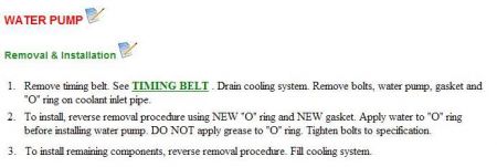

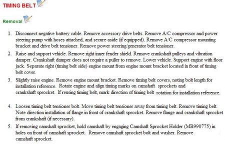

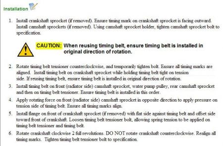

I have water leaking from under the wheel or gear (or whatever you call it) on the front of my water pump. I think it is because the bearing and the seal are cheesed. I think I need to replace the water pump. Any advice on the removal or replacement procedures would be great!

BLUELIGHTNIN6
  • 16,542 POSTS
https://images.2carpros.com/forum/automotive_pictures/261618_Noname_1416.jpg
https://images.2carpros.com/forum/automotive_pictures/261618_Noname2_417.jpg
https://images.2carpros.com/forum/automotive_pictures/261618_Noname3_156.jpg
https://images.2carpros.com/forum/automotive_pictures/261618_Noname4_76.jpg
