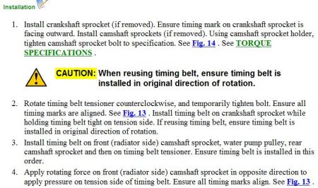

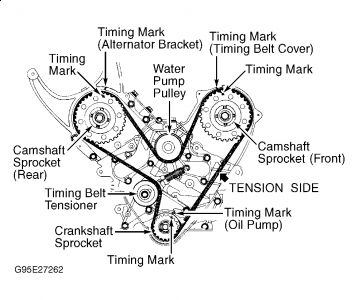

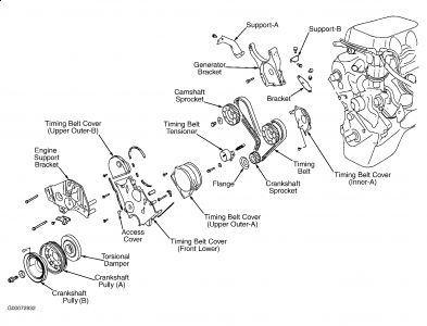

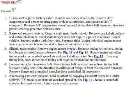

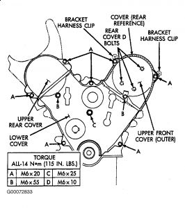

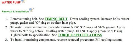

how do you change the water pump on this vehicle?
Mar 14, 2009 at 5:34 AM
ZACKMAN
  • 4,202 POSTS
Installing a new water pump on this vehicle requires the removal of the timing belt, which of course will have to be replaced as well. If you have never done timing belt before, I suggest that you have someone that has done timing belt to assist you.
https://images.2carpros.com/forum/automotive_pictures/55316_98caravanwp1_1.jpg
https://images.2carpros.com/forum/automotive_pictures/55316_98caravantb1_1.jpg
https://images.2carpros.com/forum/automotive_pictures/55316_98caravantb2_1.jpg
https://images.2carpros.com/forum/automotive_pictures/55316_98caravantb1_2.jpg
https://images.2carpros.com/forum/automotive_pictures/55316_98caravantb2_2.jpg
https://images.2carpros.com/forum/automotive_pictures/55316_98caravantb3_1.jpg
I really suggest that you invest in either a Haynes or Chilton repair manual for more in depth step-by-step and illustrations.
