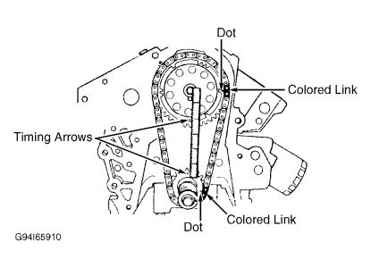

putting on the timing chain for a dogde caravan 3.3 1998 need to know the point where the timing chain must go

https://images.2carpros.com/forum/automotive_pictures/198357_Graphic_653.jpg
