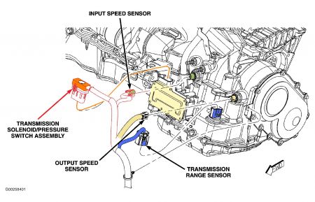

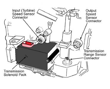

Im trying to locate the speed sensor on my Grand caravan can some one tell me (possibly show me) where it is located on my car?
Thanks!

You have two input and out put
https://images.2carpros.com/forum/automotive_pictures/99387_caravan_tranny_9.jpg
https://images.2carpros.com/forum/automotive_pictures/99387_caravan_tranny_05_2.jpg

Thank you! Thats all I can find in my book and on the car, but when I went to purchase the part it was a totally different piece and I could not find the part they sold me ANYWHERE on the car. I did change the input and output and am still having problems with the tranny, Im trying to avoid the cost of having it fixed at a shop.

what is the issue
the black bos on the tranny more common then any other
it will not up shift
Jul 7, 2008 at 12:11 PM
TRINAFRMLV
at about 35 mph it acts like its suddenly in nuetral. When I let up on the gas and slow back down its in gear again. Some times it wont shift back down so when I stop the car dies. Im getting codes 700 and 733.
Jul 8, 2008 at 2:45 AM
BMRFIXIT
  • 19,053 POSTS
Need to be checked by tranny shop
3rd gear slipping out
possible tranny need to be rebuilt
I wouldn’t waste money on sensors
only thing I would try is a new filter and oil
make sure using Chrysler tranny fluid ATF+3
Prepare yourself for a costly repair bill
