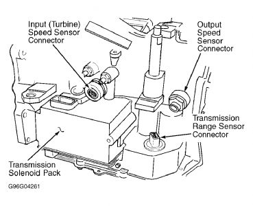

My problem is virtually the same as one that another has asked, but I'm clueless as to what your answer refers to as I have never heard the terms before. My 98 Grand Caravan shifts fine until it warms up , then won't upshift from first gear. As the other person stated, once it cools down the cycle repeats and reverse is fine. Your response to their question was this:

My question is what is a "waste gate" and where the heck do I find it?

https://images.2carpros.com/forum/automotive_pictures/99387_Graphic1_136.jpg
also I would suspect and common is the input and out put speed sensors

My "Service engine soon" light is on and every attempt made to retrieve codes by your instructions has produced no codes anywhere. Will I need to visit an auto supply store or garage and have them use a scanner to retrieve the codes and if so, is there normally a fee attached for that service? I also am wondering about the input and output sensors you mentioned. If that might be the problem, how difficult would it be to replace on my own or would it be something that needs to be done at a garage? I also need to mention that the filter and fluid has been replaced as a precaution. (tried the simple fix first)

Your right, Autozone retrieved 8 codes for me at no charge. They are: P0700, P1698, P0760, P1787, P1784, P0134, P0135, P0141. As I understand the brief explanations that came with the codes, the first 5 are about the transmission and the last 3 are about an oxygen sensor. I've spoke with a local mechanic and he suggested that they are general codes and that it needs to be put on the diagnostic machine strictly dealing with the transmission in order to be more accurate as to the problem. I relayed the possibilties you suggested may be the problem and he agreed, but also suggested the possiblity that I may need a new transmission or rebuild this one, all depending on what the diagnostic says. Any help you can give is MOST appreciated I assure you. I may be a female, but I'm not stupid when it comes to vehicles. I paid VERY close attention when my exhusband, (a genius with cars) would explain and work on our vehicles as well as others, so rest assured that I will take your advice seriously. Thanks so much for all your help so far.

Yes now the next step is you have to get the TCM scanned for tranny codes as this will help identifying the troubled area
at this point every think is possible you have a lot of codes and I do not like that
as it may be you have more then one troubled area
take it to some one you trust and local
let them scan for tranny codes
these are the steps I would take
1- scan for tranny codes
2- record all codes
3- clear codes
4- remove TCM connector and check clean and reinstall
5- take the van for a ride until check engine light come back on
6- scan for codes
7- and deal with what u have one code at a time
8- I still suspect in and output sensors and tranny solenoid pack
