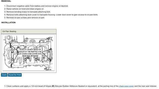

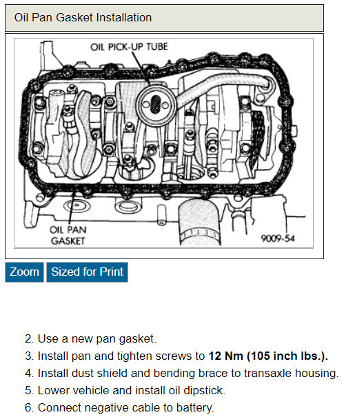

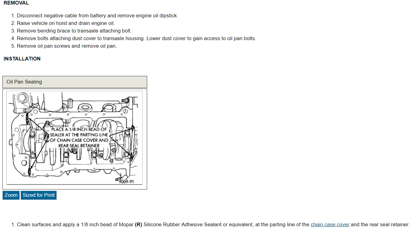

Can I easily replace the oil drain pan myself or do I need the assist of a mechanic?
Oct 26, 2009 at 10:56 PM
BMRFIXIT
  • 19,053 POSTS
You will need to drain the oil first disconnected the battery and raise the car up here are diagrams (below) that will help you see what you are in for when doing the job.
