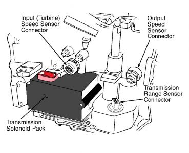

ABS light on you need a scanner to check for codes and once you do you can post them back for more info. As for the cluster since its shifting OK and all not working the most common is a bad cluster you have to remove it that could be a pain but it can be done after removing the cluster remove the cardboard cover in the back remove circuit panel board and check in the middle for a broken weld Park neutral switch is on the tranny similar to this it called tranny range switch
https://images.2carpros.com/forum/automotive_pictures/99387_caravan_tranny_7.jpg
