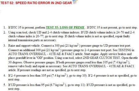

98 dodge grand caravan se 3.3L AT wont go into gear when cold. once the engine and tranny warm up its fine. hooked it up to a scan tool and it threw p0732( gear 2 incorrect ratio) and p0736 (reverse incorrect ratio) what problem are these 2 codes pointing to, is it a sensor, solonoid, or am i screwed and its much more serious than that? please help i cant afford to take this somewhere and get screwed if its something as simple as a sensor or solonoid!

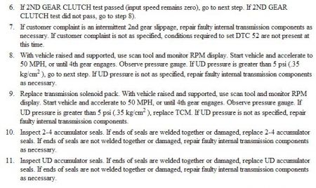

Perform the following diagnostic tests below and let me know how the outcome is.
