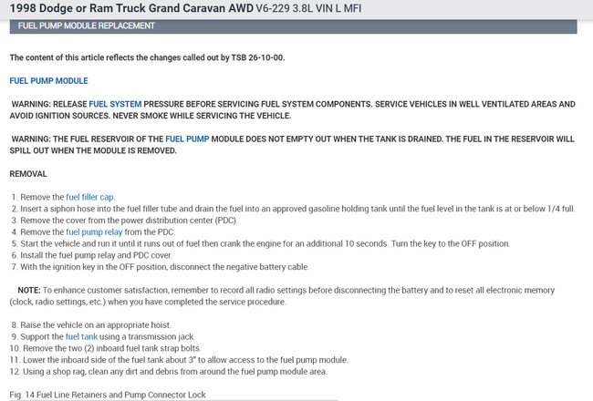

need to know when replacing the fuel pump on this caravan,do i have to drop the fuel tank,or can i go inside the van in the back and go at it from the top,you know,take the rug out and unbolt the floor panel to get into it..please help me..

Bad news you have to drop it to get at the fuel pump/module

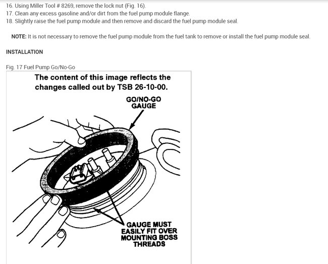

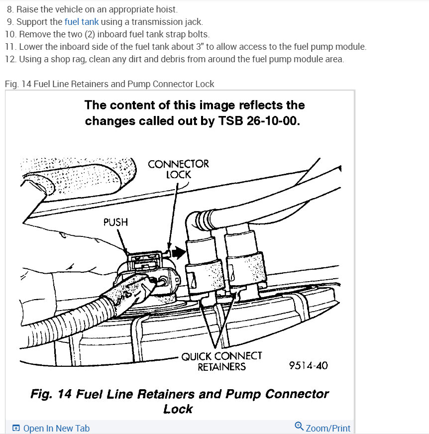

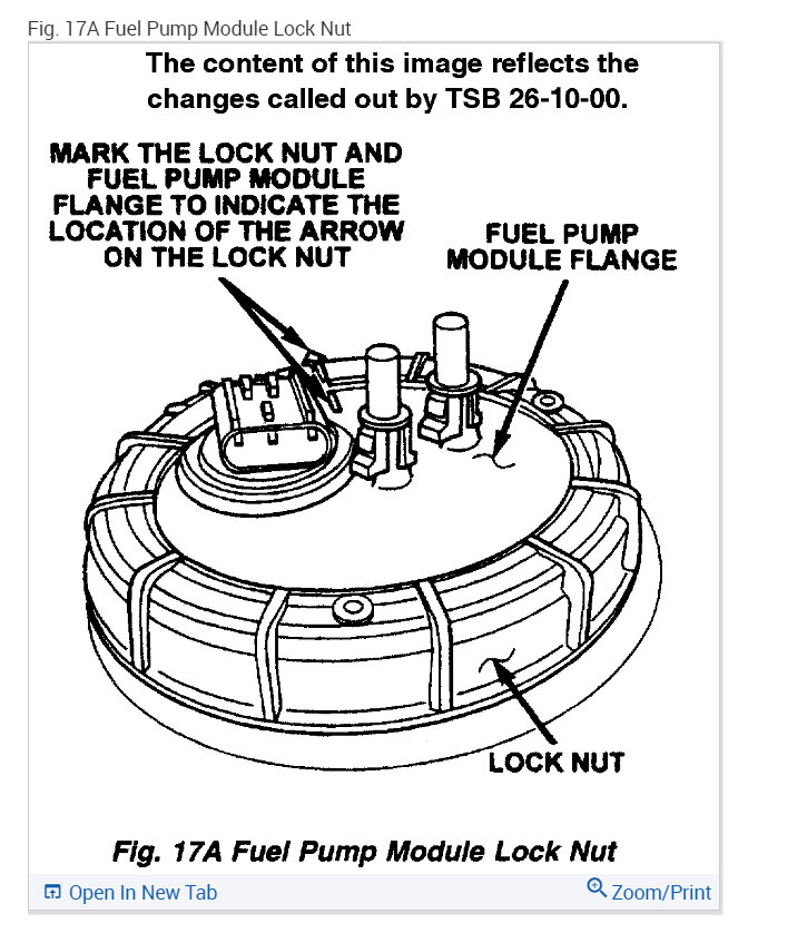

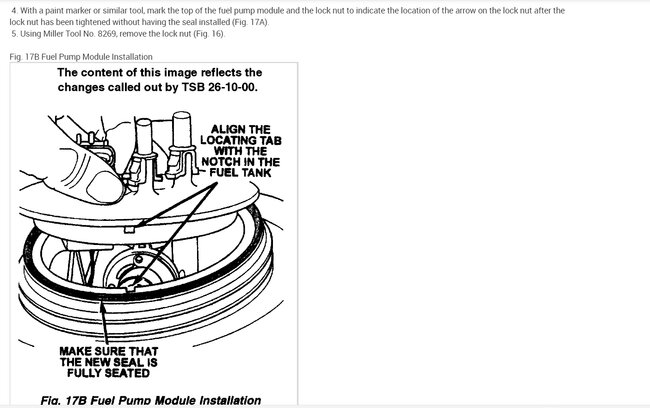

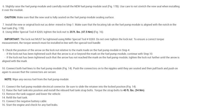

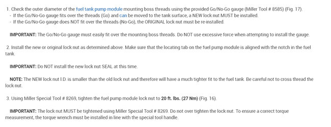

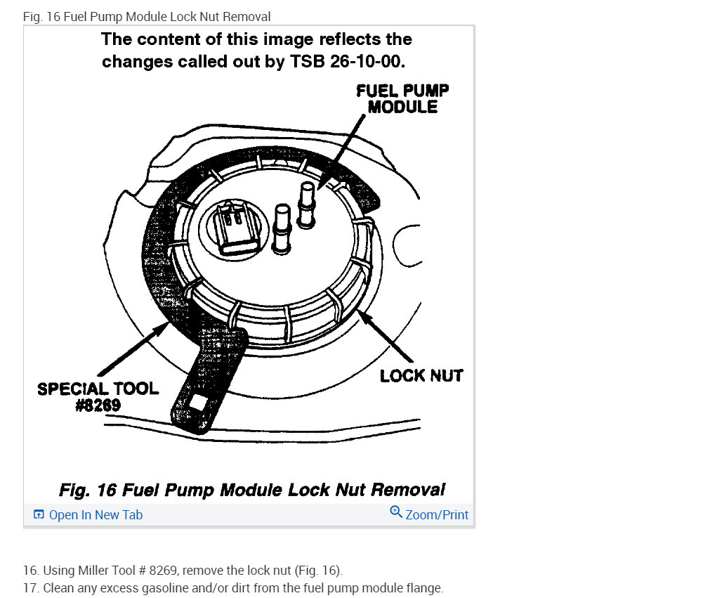

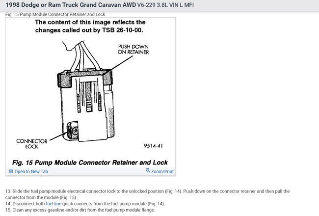

Here is how the job is done in the images below. This video can show you howe to remove the fuel before you begin, do not drop the tank with fuel in it because it is very heavy and fuel can spill.
https://youtu.be/Q5MH2gnyFH0?si=w4C3cngLKEJVpr9z
Check out the images (below). Let us know if you need anything else.
