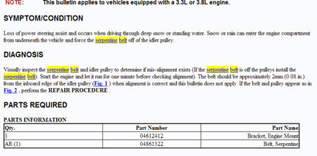

Everytime I drive my car, the belt keeps slipping off. Someone told me it might be because my bearings are worn out. Is that a easy to fix job. Something that I might be able to fix myself, or do I need to send it out for repair.

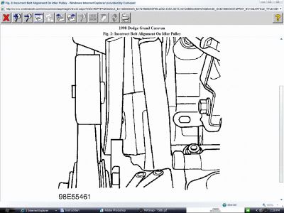

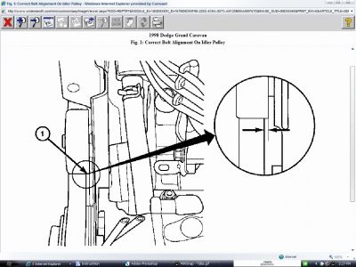

There is a Tech bulliten on your idler pulley and mounting bracket, if the belt is too close to the outter rounded edge, under some conditions it can slip off
https://images.2carpros.com/forum/automotive_pictures/62217_TSBa_1.jpg
https://images.2carpros.com/forum/automotive_pictures/62217_TSBb_1.jpg
https://images.2carpros.com/forum/automotive_pictures/62217_TSBc_1.jpg
There are replacement parts available to fix this, reference # is 07-02-99
