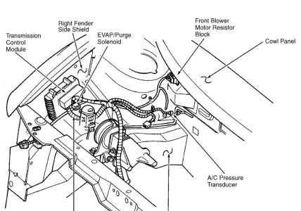

blower motor resistor location 98 caravan
May 11, 2010 at 4:22 AM
MERLIN2021
Experienced Mechanic
17,250 POSTS
Right rear of the engine compartment.
