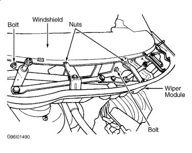

I'm trying to replace the spark plugs against the firewall. I have been inable to get to them via top and lifted from the bottom. How would I reach the back 3 spark plugs????

Here is another option you can remove the wiper module and box .
https://images.2carpros.com/forum/automotive_pictures/99387_Graphic1_264.jpg
