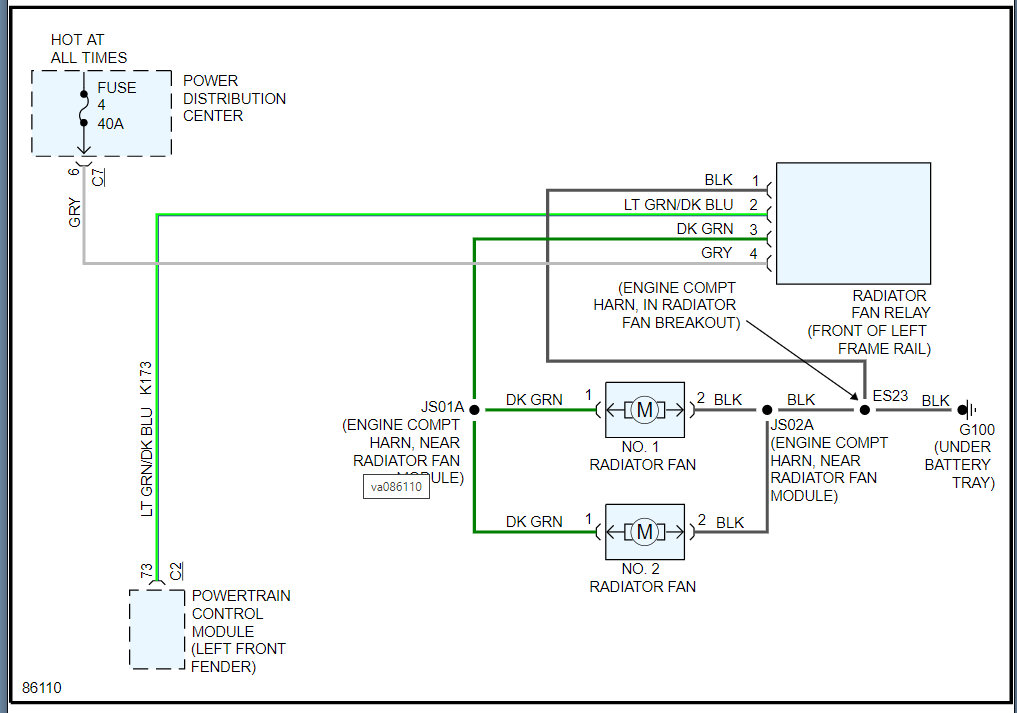

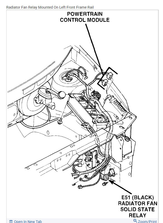

where is the relay for the cooling fan?
Jul 6, 2010 at 12:49 PM
This relay is on the driver side front frame rail.

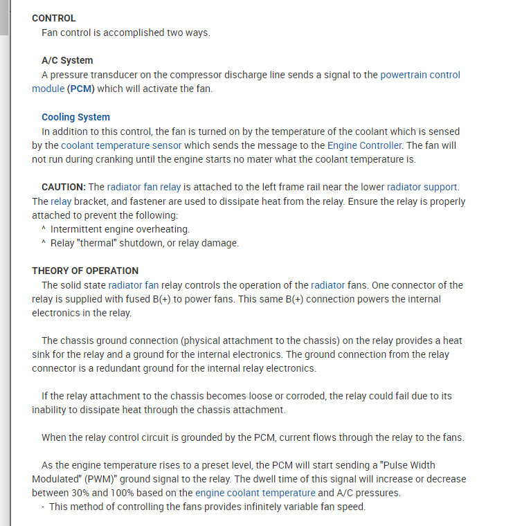

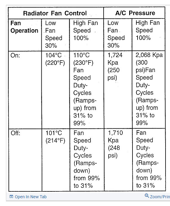

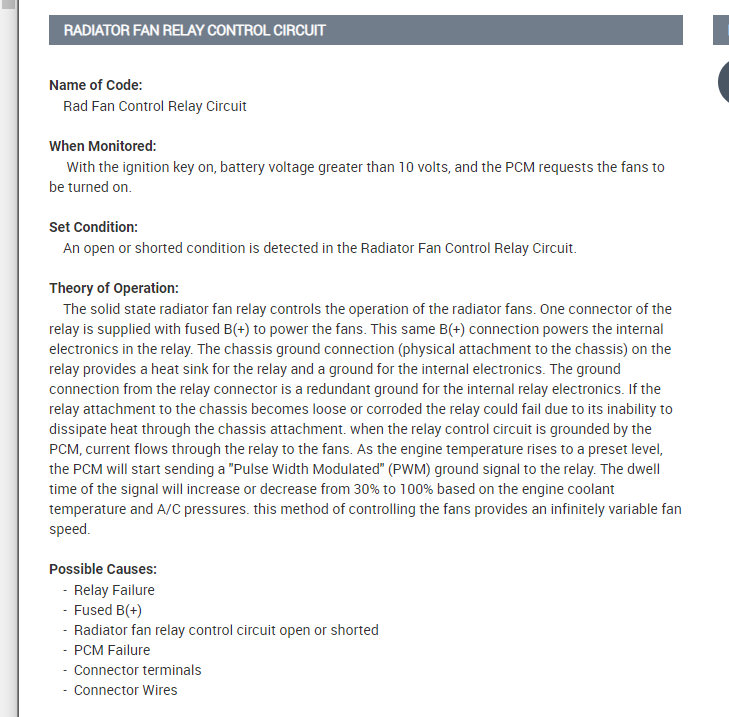

I am attaching the info below on this and so that you can not only see where it is but all the info that you will need to run through and test it. Including the parameters on when the fan should be on so that you can test to make sure it is operating correctly.
Here is a guide that will help with testing the relay as well:
Please see the info below and let us know if you have other questions. Thanks
