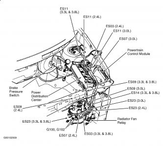

Read 11.64 V. At pig tail harness to cooling fans - and replaced whole assy. Unit. Fans work on bench test.? Hours spent ! Still dont work ?
Can jump both fan assy's. And they work fine?
What is going on ?
BEWILDERED !
Thursday, June 25th, 2009 AT 10:41 PM
BMRFIXIT
  • 19,053 POSTS
Turn AC on does the fan come on
check coolant fan switch
will not suspect fan relay module at the front left of frame support
