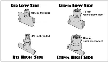

YES IF SOME ONE CAN TELL ME WHERE CAN I FIND THE LOW PRESSURE AND HIGH PRESSURE FOR A/C ON A DODGE CARAVAN 1996
Saturday, May 15th, 2010 AT 4:49 PM
MECHANIC
75,992 POSTS
The low side is between the evaporator and condenser and high side is between the compressor and evaporator. look for these fittings for R134a
