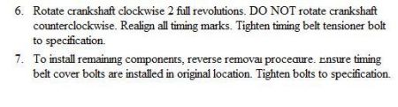

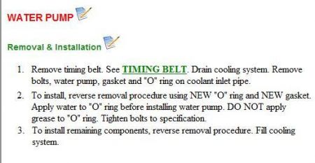

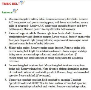

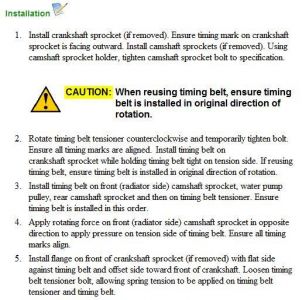

how do you change the water pump on a 1996 dodge grand caravan with a 3.0 engine. is it hard to do and i need as much detail as possible.any help will be great thank you

https://images.2carpros.com/forum/automotive_pictures/261618_1_182.jpg
https://images.2carpros.com/forum/automotive_pictures/261618_Noname2_788.jpg
https://images.2carpros.com/forum/automotive_pictures/261618_Noname_2423.jpg
https://images.2carpros.com/forum/automotive_pictures/261618_Noname3_289.jpg
