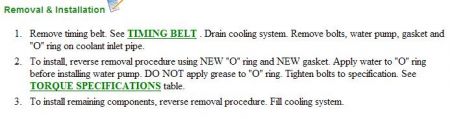

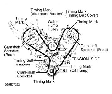

I wanted to know if you can tell me how to change a water pump on my 3.0 caravan ? I done alot of water pumps but this one is internal. im not sure in whats all involved. what do i need to remove to get to the pump ? do i need to reset the timing ?
Dec 3, 2008 at 10:19 AM
MHPAUTOS
  • 31,937 POSTS
Hi there, The timing belt must be removed to access the water pump see text & pics. Mark (mhpautos)
