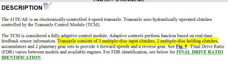

96 dodge 3.8 4 speed
tranny check as bad clutch pack coulple grand to fix
question is there only one clutch pack or is there a seperate pack for reverse
car does not work in drive but works in reverse
Jun 8, 2010 at 4:43 PM
MHPAUTOS
  • 31,937 POSTS
https://images.2carpros.com/forum/automotive_pictures/61395_Capture_25.jpg
