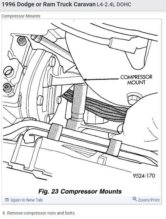

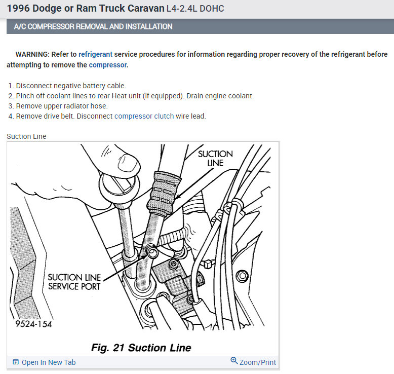

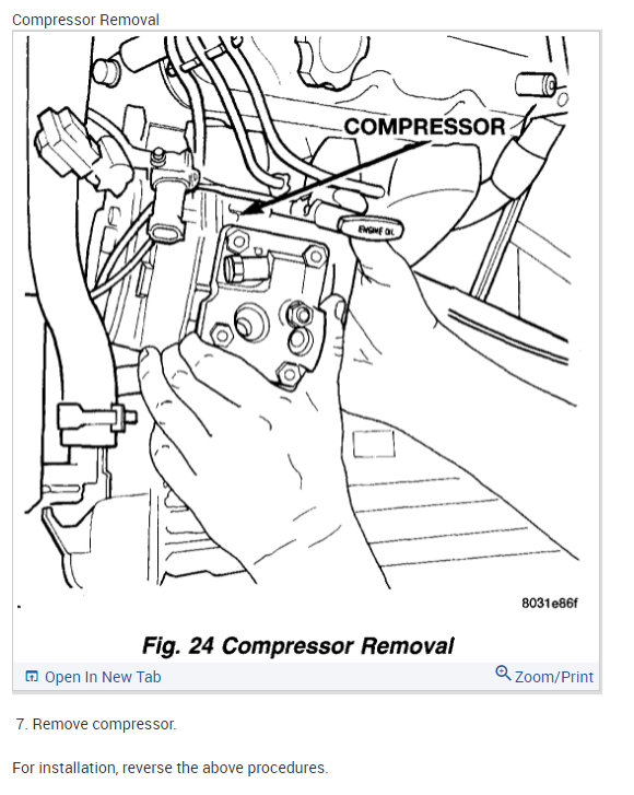

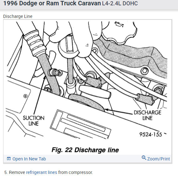

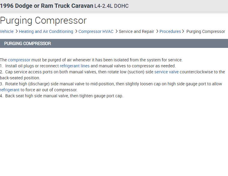

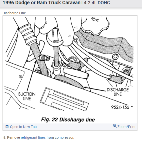

How to install an air conditioner compressor when the system has been flushed and new freon has already been put in?
Monday, July 7th, 2008 AT 5:29 PM
SQM
MECHANIC
6,383 POSTS
In order to replace the compressor without loosing the Freon, you will have evacuate the AC system into a canister using vacuum.
Here is a video that shows step by step process:
https://youtu.be/4EqdrBVb0sY
Also you might find this article helpful:
https://www.2carpros.com/articles/replace-air-conditioner-compressor
