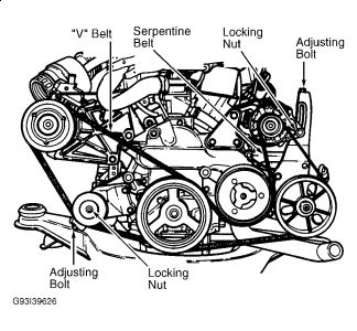

1996 Dodge Caravan removing the ac belt to replace the serp

how does the ac v belt come off dont appear to see a tensioneer to loosen it and all the pictures tell me on line is the adjusting screw but no directions

They are correct. There is a tensionier with an adjuster screw. Here is a picture:
https://images.2carpros.com/forum/automotive_pictures/249084_Dodge_Grand_Caravan_93I39626_1.jpg
First, loosten the locking nut on the front of the pulley. Then you can loosten the belt from the adjuster. Let me know if this helps. Joe
