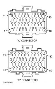

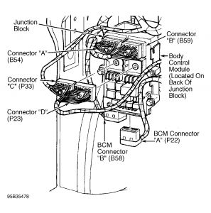

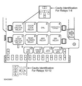

Ok the body control module controls the following, door chime, compass and mini trip computer, exterior lighting, door ajar, interior lighting, intermittent wipers, instrument cluster, door locks, power window, keyless entry and alarm. It is part of the junction box and located under the left side of the instrument panel. Now you need to disconnect the connector A in the pic included below and measure resistance on terminal number 8 (light green/red wire) to a good ground if it is 5 ohm's or better then the BCM is bad and needs replaced. Just to be sure turn on the headlights and pull the parklight relay relay number 10 in the pic below. If the headlights turn off then that ensures the BCM is bad replace it. Here is a pic of the connectors
https://images.2carpros.com/forum/automotive_pictures/249564_Graphic_28.jpg
Here is a pic of the location of the BCM and connector
https://images.2carpros.com/forum/automotive_pictures/249564_Graphic2_3.jpg
Here is a pic of the relay that needs to pulled (parklight)
https://images.2carpros.com/forum/automotive_pictures/249564_Graphic3_1.jpg
