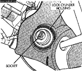

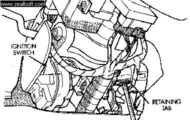

kEY HAS DIFFICULTY TURNING IN THE SWITCH. eVEN SPARE HAS SAME PROBLEM. wIGGLING KEY WILL MAKE SWITCH WORK. LOOKING FOR INFORMATION ON REPLACING THE SWITH.

disconnect battery remove plastic cover around steering put key in ignition and turn to run depress lock cyl retaining tap and remove key cylinder good luck
https://images.2carpros.com/forum/automotive_pictures/99387_cara_1.gif
https://images.2carpros.com/forum/automotive_pictures/99387_cara_3.jpg
