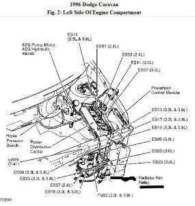

where is the fan control module located

Hello, The radiator cooling fan relay is locate on the inside frame rail on the front drivers side..... The darker line is the relay....
