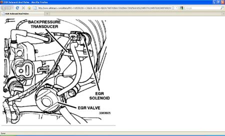

I just had my oil changed at jiffy lube and when I went to start the car, I heard a banging noise coming from the heater unit under the passenger side dashboard. It sounded to me that the vent door on the heater keeps opening and closing. The light on the dashboard says service engine soon. I had the folks at jiffy lube plug in their computer and it said "egr flow is insufficient ". They don't think the two things are related but I do. I believe the heater door and the egr valve are vacuum operated and I have a vacuum leak from the line going to the egr valve. Where can I find the egr valve on this car and check the vacuum line coming from it?

Which engine do you have 3.0 3.3 or 3.8L engine.Let me know so i can help you out.
Oct 20, 2010 at 1:32 PM
JOHN WEST
My car is a 1996 dodge grand caravan with a 3.3 litre engine.
Oct 20, 2010 at 2:21 PM
SATURNTECH9
  • 30,869 POSTS
https://images.2carpros.com/forum/automotive_pictures/416332_1996_dodge_caravan_3_1.jpg
It's near the throttle body.
Oct 20, 2010 at 3:48 PM
JOHN WEST
Thanks. I found the egr valve and solenoid. Lo and behold, I found a broken vacuum line. I repaired it but I,m not sure it solved the problem. How do I reset the car computer so it doesn't say "service engine soon"? also, The banging noise still sounds from the heater box under the dash. I might still have another vacuum leak. Thank you very much. You have been very helpful.
