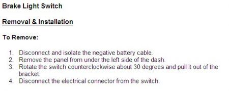

how do u replace the brake light switch?trying to do it my self,i need where its located at and how to put it in...its a 96 dodge grand caravan..

Welcome to the forum. My info showed, picture below,. The switch should be activated by the brake pedal arm, follow the arm.
https://images.2carpros.com/forum/automotive_pictures/170934_brake_lamp_switch_2.jpg
