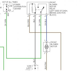

MY turn signals don't work. My heater blowers quit. My abs light and air bag lights came on. None of my rear controls (wipers, defrost,washer) . This all happened at the same time. Could it be one relay ?

Might be an issue with feed circuit to or from the ignition switch? With multiple issues, I usually track the voltage feed for one system. You can check voltage at front blower motor. Dark blue wire is voltage when relay is energized. Voltage to the coil side of relay comes from the ignition switch.
https://images.2carpros.com/forum/automotive_pictures/170934_caravan_front_blower_1.jpg
