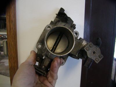

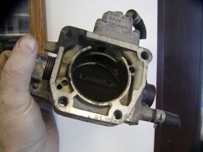

The first thing I would want to look at is the throttle body. This may be a multiple symptom problem, but we have to start somewhere. Get the codes checked, regardless of the CEL not bing on. There should be history codes stored in it. find them and post them. The loss of resistance on the accelerator may be a cable stuck and the throttle plate hanging up. I suspect a carbon build up in the throttle plate, and recommend looking at it and unless it is clean, get it cleaned. Additionally the intake valves should be cleaned if this situation is present.
https://images.2carpros.com/forum/automotive_pictures/30961_P1190121_1.jpg
This is the back side or from the engine side out view of a dirty throttle bore.
https://images.2carpros.com/forum/automotive_pictures/30961_P1190122_1.jpg
This is the view when you first look at the throttle bore from the outside looking into it. See how clean it is? You need to pivot the palte with the accelerater arm that the cable is attached to. I don't expect this will be the end all to the situation, but you don't want to have an accelerator that sticks.

My machanic has cleaned the throttle body. He suggested this to me also and so it hasnt fixed the problem.
Also I forgot to sat that after the pedal goes to the floor it takes a few seconds but the pedal gets works again.
