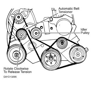

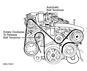

1995 Dodge Caravan 6 cyl Front Wheel Drive Automatic
I need the routing for the belt on the engine

Top is 3.0 bottom 3.3 and 3.8.
https://images.2carpros.com/forum/automotive_pictures/62217_belt30_1.jpg
https://images.2carpros.com/forum/automotive_pictures/62217_belt38_1.jpg
