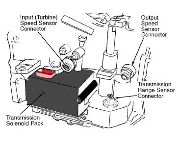

Check fuses
check for codes
most common is the tranny solenoid pack mounted on the side of the tranny
and also the input and out put sensors
codes will help you pin point troubled area
https://www.2carpros.com/forum/automotive_pictures/99387_caravan_tranny_2.jpg
