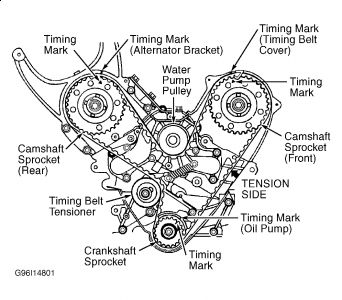

I replaced the water pump in my 94 Caravan 3.0 6 cyl and i messed up the timing. i need to know where the marks go on the crankshaft and ect. to re-time any help would be greatly apreciated thanks

See diagram
https://images.2carpros.com/forum/automotive_pictures/198357_Graphic_436.jpg
