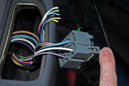

I have the same issue with only the driver side window. removed switch on driver side and there is power to the passengerr side but no power to driver side. Does that tell you anything? Thanks
https://images.2carpros.com/forum/automotive_pictures/589849_DSC_0343_3.jpg

That is odd. The power originates at the driver's door. Have you checked to see if there are any wire breaks between the door and the door frame?
