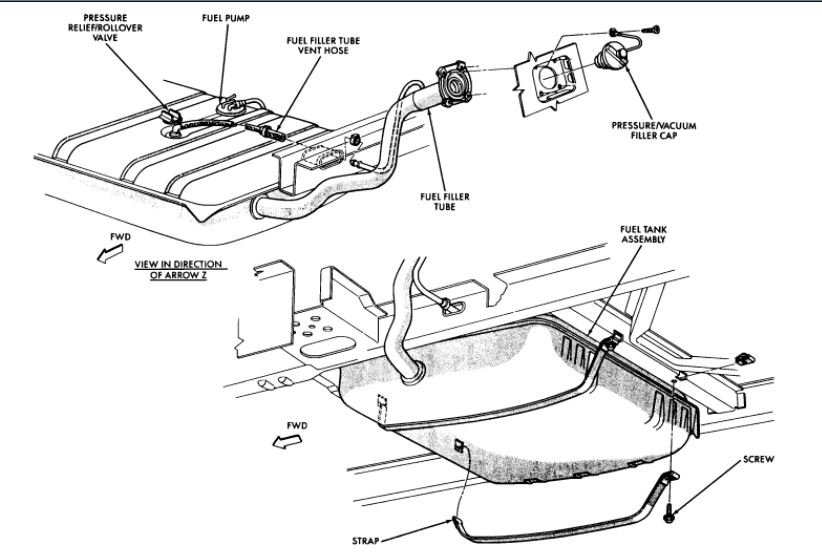

gas leak where the filler tube goes into the gas tank?
1994 DODGE CARAVAN
BLVANDAME
I recently replaced my in tank fuel pump. I now have a gas leak where the filler tube goes into the gas tank at the gasket that is there. What is the name of the part that I am looking for?
Jan 17, 2010 at 4:30 PM
Good morning,
It is called a Gromit. It is the one that goes in the tank and the neck fits through it with lube and prevents leaking.
It just pops out with the filler neck removed. The new one should be installed with Vaseline so it seats correctly.
