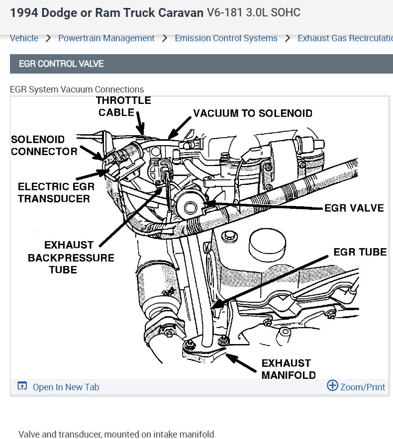

Where is the location of the EGR transducer solenoid in a 1994 Dodge Caravan with the 3.0 liter V6

The valve is right next to the egr valve. Here is the location of the EGR and control solenoid. Check out the images (below). Let us know if you need anything else.
