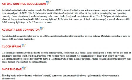

1994 Dodge Caravan air bag light came up
HAJIAGHA
  • 1994 DODGE CARAVAN
Any ideas what to do?
are need to scan cod? Why light came on and did not go off?

The codes or air bag light is telling you whats defective! Get the codes read...here's a bit of info...DO NOT mess with the air bags until you have removed the neg battery cable for 5 mins! Deployment and injury may result!
https://www.2carpros.com/forum/automotive_pictures/62217_Airbag94p_copy_1.jpg
https://www.2carpros.com/forum/automotive_pictures/62217_30961_mitchell_2_31.jpg
