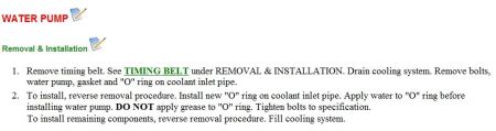

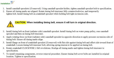

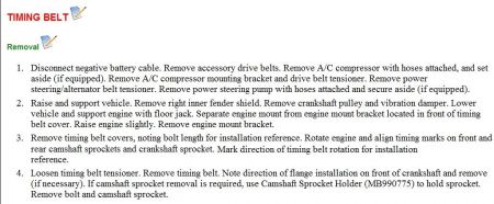

I need to know how to replace awater pump on my 1993 dodge caravan and any help would be greatly appreiciated.
