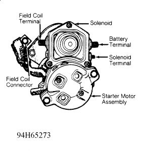

It was difficult to remove starter but I can't see the bolts or nuts to remove solenoid. I want to bench test and replace them if necessary. Is ther any drawing that would show where the mounting bolts are for solenoid?

Remove starter. Remove 2 starter solenoid field terminal nuts. Remove 3 solenoid mounting screws and remove solenoid. Remove 2 through bolts securing starter drive end housing to motor housing. Remove rubber seal and pull gear and clutch assembly from drive housing. To install, reverse removal procedure.
Nippondenso
Remove starter. Remove 2 gear housing attaching screws and separate gear housing from solenoid housing. Remove pinion gear, pinion gear bearing, and drive gear from gear housing. Remove starter gear and clutch assembly from solenoid housing. Clean and lubricate pinion gear, bearing and drive gear and reinstall in gear housing. Install starter gear and clutch assembly in solenoid. To install starter, reverse removal procedure.

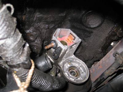

I removed 3 screws as suggested but only the plunger came out of solenoid. Solenoid is still there and I don't see nuts, bolts or screws that hold the solenoid. Also if the information helps, yes donation can be made by m.o. because I don't use credit card. thank u much.

is the starter still in the truck ?

The Starter is out. I also removed 3 screws (short) from solenoid and just the plunger and cover came out as u can see in the photo. The solenoid is still there except the plunger. I can't see the nut or bolts that hold the solenoid.

You're making this way too complicated. Are you trying to solve an intermittent loud clunk / no-crank? Once you pulled the plunger out, look at the two copper contacts. You'll see they're burned away. Replacements and shipping are around 20 bucks. The small one is called the "battery" terminal. The other one has three versions; symmetrical, offset to the left, and offset to the right. You can never know which style you have until you peek inside.
Takes about 15 minutes to replace them once the starter is off the engine.

THANK U CARDIODOC even though ur information came in late. In the meantime I cleaned the plunger and starter brushes etc. lubed the bearings and did not find anything burnt so I put everything back making sure every contact is clean. Of course I don't do things without a prayer. So it cranked the engine very well and started on April 23rd. It's still working.
