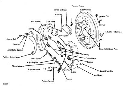

How do I remove the rear brake drums. They seem to be locked into place?

Use a hammer and wd40 TURN down the adjuster
