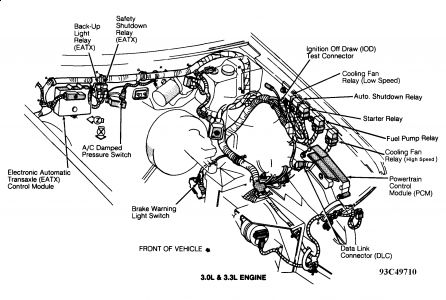

Hi- I was wondering if U can tell me where the fuel relay switch is for a 93 dodge caravan.

Fuel Pump Relay
3.0L & 3.3LOn left front inner fender, near shock tower.
