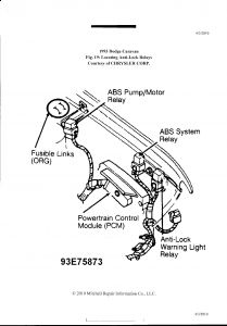

IS THERE A WAY TO TEST THE POWER TO THE ABS UNIT? IF SO HOW AND WHERE.

It uses 3 seperate relays, the motor pump relay is the one to test. You can jump it but it needs power. The power is from a fusible link, so they all must be checked. They are near the battery all taped together. Power on one side and none on the other side tells you it burnt. Use a regular fuse holder to repair it. I would use a 20 amp. The color is orange wire. You'll need a test light for checking everything. The pump relay also gets power from the ignition switch. I'll send a photo of their locations.
https://images.2carpros.com/forum/automotive_pictures/401109_bendix_10_for_93_caravan_sbody_1.jpg
hope this helps you, ok. It isn't mine, it's from 2carpros. So thank them, ok. Good luck. Information on testing fuses is here on the website as is a test light.
