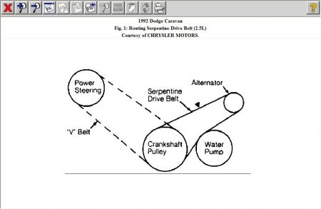

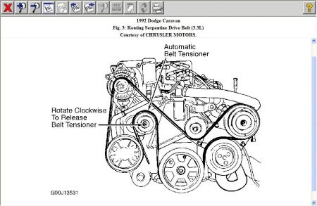

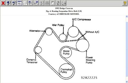

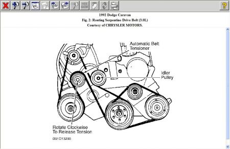

I NEED A SERPINTINE BELT ROUTING MAP FOR A 1992 DODGE CARAVAN

Okay Sir I see pick your engine
https://images.2carpros.com/forum/automotive_pictures/12900_belt125_1.jpg
https://images.2carpros.com/forum/automotive_pictures/12900_belt230_1.jpg
https://images.2carpros.com/forum/automotive_pictures/12900_belt3_1.jpg
https://images.2carpros.com/forum/automotive_pictures/12900_belt4_1.jpg
