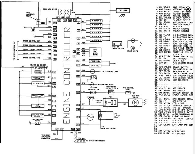

Dose anyone know where the fuel pump relay is on my 1991 dodge caravan (3.3 L V6)? I have looked on the drivers side fender and it is not there, I have called the dealer and ask them, they say it is on the firewall with one screw holding it on and gave me a part number, but I can not find that relay anywhere. It is not in the fuse panel ether. please help I am pulling my hair out over here.
Feb 8, 2008 at 9:18 AM
  • 55,512 POSTS
There is no fuel pump relay per say because it is control by the ASD relay located under the hood
Here is a wiring diagram notice the fuel pump in the right upper corner.
Here is a guide to help you test the relay
Please run some tests and get back to us so we can continue helping you.

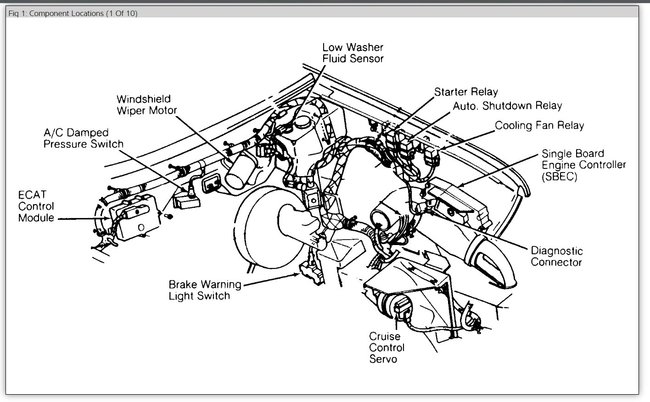

Where is it found and what does it look like>
May 12, 2017 at 12:04 PM (Merged)
BMRFIXIT
  • 19,053 POSTS
Under hood near battery in the fuse AND relay box
MOMMOMPOPPIE
where is the fuel pump relay on the power distribution center on 1996 dodge caravan
ERNEST CLARK
  • 1,730 POSTS
second from the bottom on the left.
CARADIODOC
  • 34,394 POSTS
Second from the end, next to the automatic shutdown relay. It's the middle of the three smaller relays.
