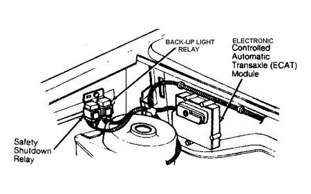

There are 2 relays in my van. They are near the jack in the hood of the van. They are at the top left. They are both black. Does anyone have a clue what these relays are? Pep Boys, Auto Zone, and Dodge haven't been able to tell me. The reason I am asking is because these relays seem to be draining my battery. A diagnositc meter showed that these 2 relays are running even when my van is off and they are draining my battery.[img:7419607051]http://www.2carpros.com/forum/automotive_pictures/162689_van_relay_switches_001_1.jpg[/img:7419607051]
[img:7419607051]http://www.2carpros.com/forum/automotive_pictures/162689_van_relay_switches_002_2.jpg[/img:7419607051]

how about this one hope that help let me know
https://images.2carpros.com/forum/automotive_pictures/99387_90_dodge_1.jpg
