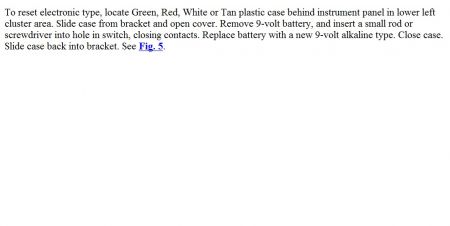

Please email and explain how to reset Maintance require light and how to fix left blinker light. Thanks advance

Don't know if this procedure will work, it's all I could find for the maintenance reset?
