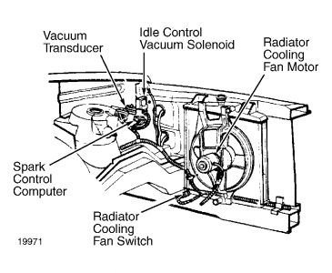

1986 Dodge Caravan spark control computer
STEVEGOOD
Electrical problem
1986 Dodge Caravan 4 cyl Front Wheel Drive Automatic
I cant find this? I just bought a manual and it does not tell me where it is located.
May 28, 2010 at 5:49 AM
DOCFIXIT
  • 18,828 POSTS
2.2L see diagram
https://images.2carpros.com/forum/automotive_pictures/198357_Graphic_466.jpg
2.6L upper right side dash
