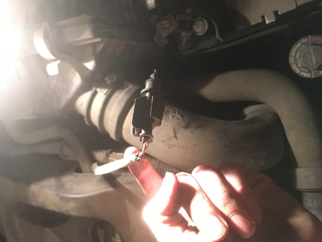

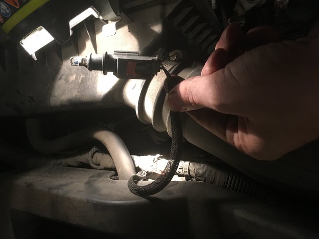

JOE_SKI
Same problem, all the aforementioned fuses are good. I am thinking at this point it is the TIPM. Other possibilities?
Second question: found the picture wire stemming off of one of the wire clusters. I cannot find a receptacle for it. What is that for?

  • 55,433 POSTS
Yes, the TIPM is what fixes this problem, if you get a new one they are plug and play you do not need to initialize them.

The sensor looks like an air temperature sensor which plugs into the air box or air intake tube (look under for a hole).
