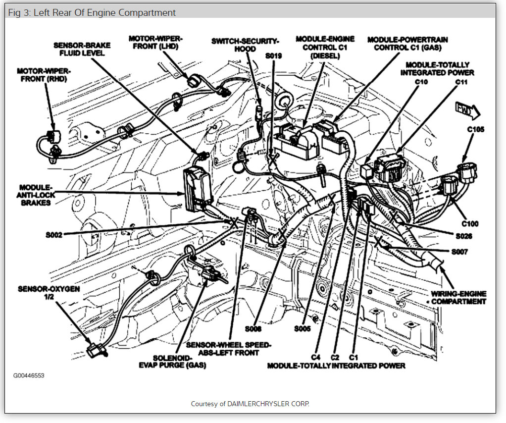

Electrical problem 4 cyl Front Wheel Drive Automatic 107000 miles

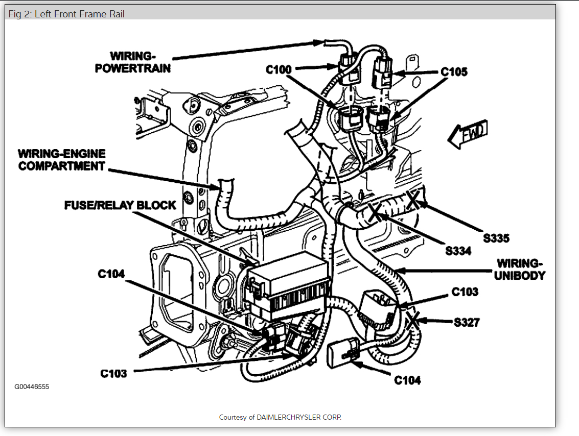

The turn signals (both front and rear) do not work. I can not find the fuse in the fuse panel in the engine compartment or I can not find the turn signal relay location,if it has one. I have resonanable electrical skills, but do not know where to start on this problem. Would you please give me some ideas as to where to start on this problem.
PS: I have checked the light bulbs and they are ok.
Aug 30, 2009 at 8:27 PM
BLUELIGHTNIN6
  • 16,542 POSTS

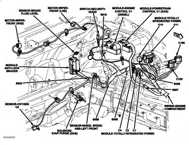

your vehicle uses the totally integrated power module (TIPM) to control the signals and hazard lamps. the TIPM is located on the left side of the engine compartment, picture is below.
https://images.2carpros.com/forum/automotive_pictures/261618_Graphic_143.jpg

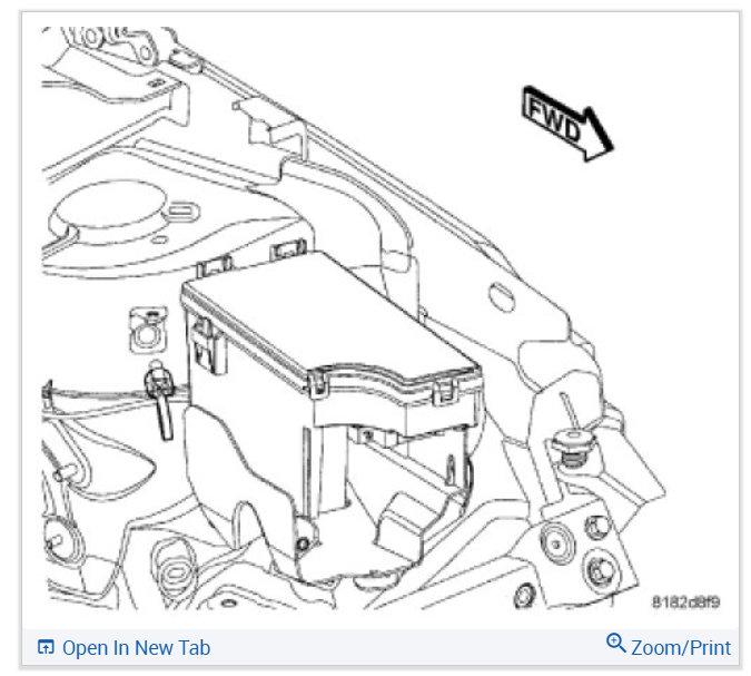

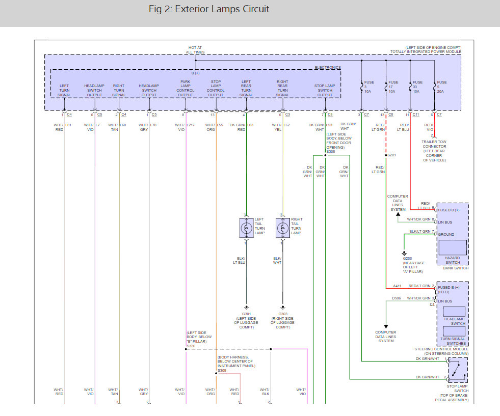

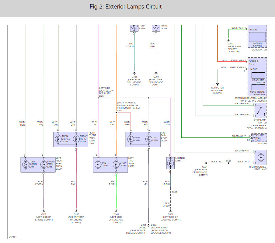

Here are some better diagrams for the blinker wiring diagrams so you can see how the system works and TIPM so you can check the fuses #3, 17, 33 and 5.
Nov 9, 2019 at 1:52 PM
DALE FAIRBANKS
Thank you so much it was fuse #33 i did not know the TIPM had so many fuses that went to different things, I love this site btw.

JOE_SKI
Same problem, all the aforementioned fuses are good. I am thinking at this point it is the TIPM. Other possibilities?

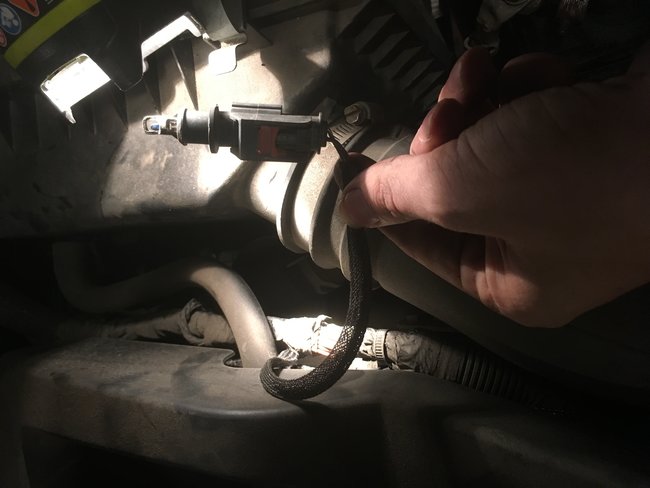

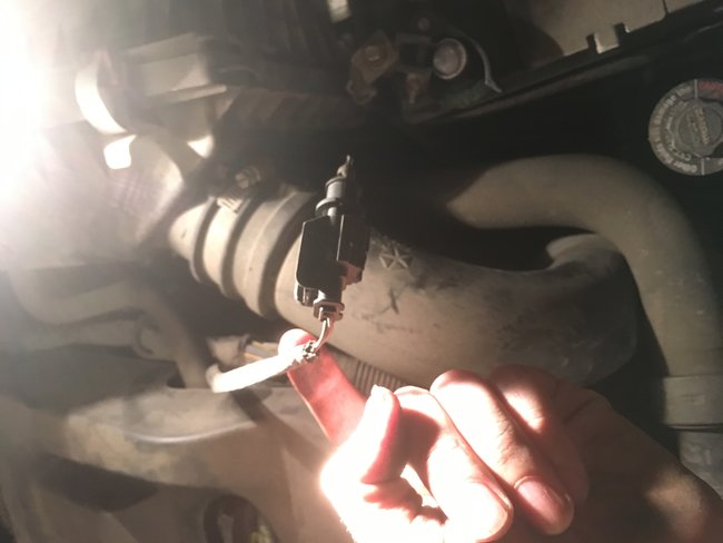

Second question: found the picture wire stemming off of one of the wire clusters. I cannot find a receptacle for it. What is that for?
  • 54,840 POSTS
Yes, the TIPM is what fixes this problem, if you get a new one they are plug and play you do not need to initialize them.

The sensor looks like an air temperature sensor which plugs into the air box or air intake tube (look under for a hole).
